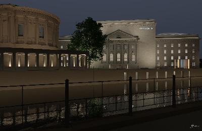

mi-bthmb.jpg Berlin Museum Island
The image was rendered for a competition dealing with the design of the urban space around the assembly of historical museum buildings. The lighting should create a quiet atmosphere, emphasizing the big block of the Pergamon Museum which is a sort of "treasure chamber".

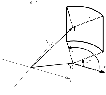

arc.png the 'arc' primitives:
the start and end angle (a0, a1) and the orientation from which they are counted have to be added to the normal descriptions.
