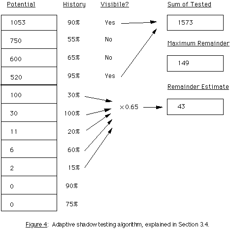

Figure 4 shows a simple example of how this works. The left column represents our sorted list of potential light source contributions for a specific sample point. We proceed down our list, checking the visibility of each source by tracing shadow rays, and summing together the unobstructed contributions. After each test, we check to see if the remainder of our potential contributions has fallen below some specified fraction of our accumulated total. If we set our accuracy goal to 10%, we can stop testing after four light sources because the remainder of the list is less than 10% of our known direct value. We could either add all of the remainder in or throw it away and our value would still be within 10% of the correct answer. But we can do better than that; we can make an educated guess at the visibility of the remaining sources using statistics. Taking the history of obstructed versus unobstructed shadow rays from previous tests of each light source, we multiply this probability of hitting an untested source by the ratio of successful shadow tests at this point over all successful shadow tests (2/(.9+.55+.65+.95) == 0.65 in this example), and arrive at a reasonable estimate of the remainder. (If any computed multiplier is greater than 1, 1 is used instead.) Our total estimate of the direct contribution at this point is then the sum of the tested light sources and our statistical estimate of the remainder, or 1616 in this example.

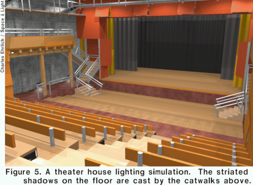

Figure 5 shows a theater lighting simulation generated by Radiance in 1989. This image contains slightly over a hundred light sources, and originally took about 4 days to render on a Sun-4/260. (The equivalent of about 5 Vax-11/780's.) Using our adaptive shadow testing algorithm reduced the rendering time to 2 days for the same image. The time savings for scenes with more light sources can be better than 70%, especially if the light sources have narrow output distributions, such as the spotlights popular in overlighted retail applications.

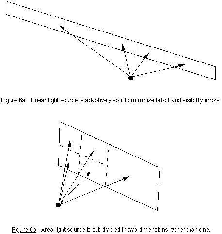

In our adaptive technique, we send multiple rays to a light source if its extent is large relative to its distance. We recursively divide such sources into smaller pieces until each piece satisfies some size/distance criterion. Figure 6a shows a long, skinny light source that has been broken into halves repeatedly until each source is small enough to keep penumbra and solid angle errors in check. Figure 6b shows a similar subdivision of a large rectangular source. A point far away from either source will not result in subdivision, sending only a single ray to some (randomly) chosen location on the source to determine visibility.
