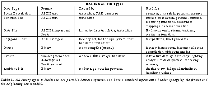

Radiance is a collection of C programs designed to work in concert, communicating via the standard data types listed in Table 1. The system may be compiled directly on most UNIX platforms, including SGI, Sun, HP, DEC, Apple (A/UX), and IBM (RS/6000). Portability is maintained over 60,000+ lines of code using the Kernighan and Ritchie standard [11] and conservative programming practices that do not rely on system-specific behaviors or libraries. (In addition to UNIX support, there is a fairly complete Amiga port by Per Bojsen, and a limited MS-DOS port by Karl Grau.)

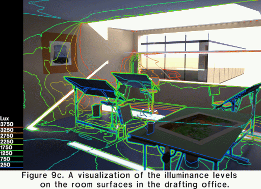

Although the addition of a control program is a big improvement, there are still many aspects of Radiance that are not easily accessible to the average user. We have therefore added a number of utility scripts for performing specific tasks from the more general functions that constitute the system. One example of this is the falsecolor program, which calls other image filter programs and utilities to generate an image showing luminance contours or other data associated with a scene or rendering. Figure 9c shows our previous rendering (Figure 9a) superimposed with illuminance contours. These contours tell the lighting designer if there is enough light in the right places or too much light in the wrong places -- information that is difficult to determine from a normal image.
