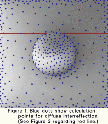

Figure 1 looks down on a diffuse sphere in a room with indirect lighting only. A blue dot has been placed at the position of each indirect irradiance calculation. Notice that the values are irregularly spaced and denser underneath the sphere, on the sphere and near the walls at the edges of the image. Thus, the spacing of points adapts to changing illumination to maintain constant accuracy with the fewest samples.

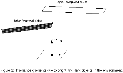

Our hemisphere samples not only tell us the total indirect illumination, they also give us more detailed information about the locations and brightnesses of surfaces visible from the evaluation point. This information may be used to predict how irradiance will change as a function of point location and surface orientation, effectively telling us the first derivative (gradient) of the irradiance function. For example, we may have a bright reflecting surface behind and to the right of a darker surface as shown in Figure 2. Moving our evaluation point to the right would yield an increase in the computed irradiance (i.e. the translational gradient is positive in this direction), and our samples can tell us this. A clockwise rotation of the surface element would also cause an increase in the irradiance value (i.e. the rotational gradient is positive in this direction), and our hemisphere samples contain this information as well. Formalizing these observations, we have developed a numerical approximation to the irradiance gradient based on hemisphere samples. Unfortunately, its derivation does not fit easily into a general paper, so we refer the reader to the original research [28].

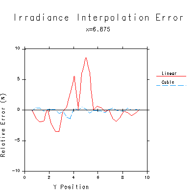

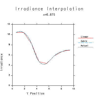

Figure 3a,b. Plots showing the superiority of gradient interpolation for indirect irradiance values. The reference curve is an exact calculation of the irradiance along the red line in Figure 1. The linear interpolation is equivalent to Gouraud shading between evenly spaced points, as in radiosity rendering. The Hermite cubic interpolation uses the gradient values computed by Radiance, and is not only smoother but demonstrably more accurate than a linear interpolation.
Knowing the gradient in addition to the value of a function, we can use a higher order interpolation method to get a better irradiance estimate between the calculated points. In effect, we will obtain a smoother and more accurate result without having to do any additional sampling, and with very little overhead. (Evaluating the gradient formulas costs almost nothing compared to computing the hemisphere samples.)
Figure 3a shows the irradiance function across the floor of Figure 1, along the red line. The exact curve is shown overlaid with a linearly interpolated value between regularly spaced calculation points, and a Hermite cubic interpolation using computed gradients. The cubic interpolation is difficult to separate from the exact curve. Figure 3b shows the relative error for these two interpolation methods, clearly demonstrating the advantage of using gradient information.
