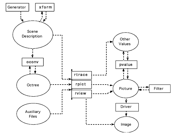

Figure 1
The diagram in Figure 1 shows the flow between programs (boxes) and data (ovals). The central program is rpict, which produces a picture from a scene description. Rview is a variation of rpict that computes and displays images interactively, and rtrace computes single ray values. Other programs (not shown) connect many of these elements together, such as the executive programs rad and ranimate, the interactive rendering program rholo, and the animation program ranimove. The program obj2mesh acts as both a converter and scene compiler, converting a Wavefront .OBJ file into a compiled mesh octree for efficient rendering.
A scene description file lists the surfaces and materials that make up a specific environment. The current surface types are spheres, polygons, cones, and cylinders. There is also a composite surface type, called mesh, and a pseudosurface type, called instance, which facilitates very complex geometries. Surfaces can be made from materials such as plastic, metal, and glass. Light sources can be distant disks as well as local spheres, disks and polygons.
From a three-dimensional scene description and a specified view, rpict produces a two-dimensional image. A picture file is a compressed binary representation of the pixels in the image. This picture can be scaled in size and brightness, anti-aliased, and sent to a graphics output device.
A header in each picture file lists the program(s) and parameters that produced it. This is useful for identifying a picture without having to display it. The information can be read by the program getinfo.
