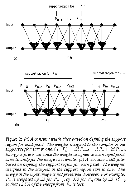

Figure 2 diagrams typical digital filters. A support region is defined for each output pixel. This region may be uniform, as shown in (a). This has the energy preserving property we seek, but has the disadvantages of blurring detail and not adequately distributing some values. A variable width region may be used to change the influence of some input samples [6]. However, as shown in the example in (b), this type of variable width kernel does not preserve all of the energy in the original sample set.

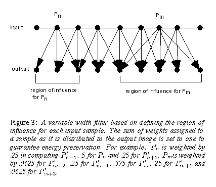

We propose constructing energy preserving filters based on the region of influence of each input sample, rather than defining a support region for each output sample. This is diagrammed in Fig. 3. A region is defined for each input sample. The weights assigned to the sample as it is distributed to the output image sum to one, and energy is preserved. By varying the region of influence for each input sample, large areas of the image can remain unaffected by the filter and the input image is disrupted a minimal amount.
